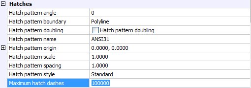

Defining the MAXHATCH setting
Do one of the following:
In the command bar type maxhatch, then press Enter.
Type a new value and press enter.
In the Settings
dialog, go to Drawing > Drafting >
Entity Creation > Hatches.
Type a new value in the Maximum hatch dashes settings field.
