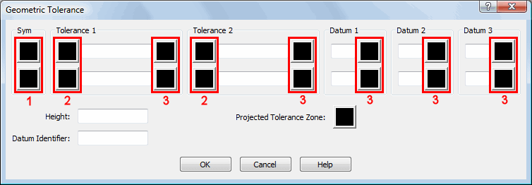

Geometric Tolerance dialog
  1. Geometric Tolerance Symbol buttons.
    Click to open the Symbol palette.
  2. Diameter Symbol option buttons.
    Click to add the diameter symbol.
  3. Material Condition buttons.
    Click to open the Material Condition palette.
