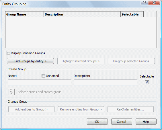

The Entity Grouping dialog window opens:
  1. Do one of the following:
  2. Type a name in the Name field.
  3. Check the Unnamed option to create an unnamed group.
  1. (option) Type a description in the Description field.
  2. (option) Check / uncheck the Selectable option.
  3. Click the Select entities and create group button.
    The Entity Grouping dialog temporarily closes to let you select entities.
  4. Select the entities you want to include in the new group.
  5. Right click to conclude the selection of entities.
    The Entity Grouping dialog reopens.
    The newly created group is added.
  6. Click the OK button to close the Entity Grouping dialog

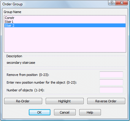

  1. Click the Re-Order entities button.
    The Order Group dialog opens:
  1. (option) Click the Highlight button to see the current position of each entity.
    The Object Grouping box opens.
  2. (option) Click the Reverse Order button to reverse the order of all entities in the group.
  3. (option) To change the order of a single entity do the following:
  4. In the Remove from position field type the current position of the entity you want to move.
  5. In the Enter new position number for the object field type the new position.
  6. (option) Type the number  of objects you want to reorder in the Number of objects field.
  1. Click the Re-Order button.
    A message box displays.
