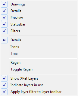

View Menu
Drawings
Toggles the display of the Drawings panel.
Details
Toggles the display of the Details panel.
Preview
Toggles the display of the Preview panel.
StatusBar
Toggles the display of the Status Bar.
Filters
Toggles the display of the Filters panel.
Details
Switches the display in the Details panel to Details view.
Icons
Switches the display in the Details panel to Icons view.
Regen
Forces the drawing display to be regenerated.
Toggle Regen
Toggles the automatic regen of the drawing display.
Show XRef Layers
Toggles the display of Xref layers in the Details panel.
Indicate layers in use
Toggles the SHOWLAYERUSAGE system variable On/Off.
Apply layer filter to layer toolbar
Applies the current layer filter to the Layer control on the Entity Properties toolbar.

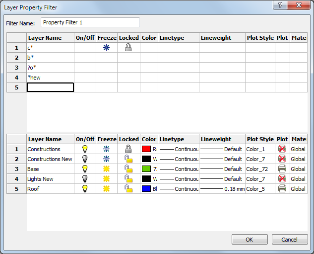

To create a new layer filter definition:
  1. Click the New button () on the Filter Panel toolbar.
    The Layer Property Filter dialog box displays:
  2. Type a name in the Filter Name field.
  3. (option) Type a search string in the Layer Name field (see Filter Text).
  4. (option) Click a property column, then set a filter criterion for this property.
    Multiple properties can have criterion applied.
  5. (option) Repeat steps 3 and 4 for each new row in the layer filter definition.
  6. Click the OK button to save the layer filter.
