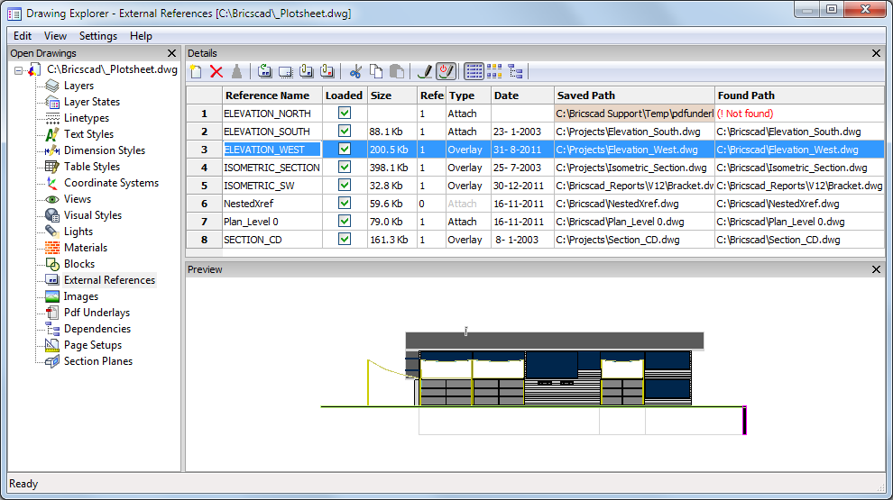

: xref
Displays Drawing Explorer:
Attach a DWG file, or change the properties of existing xrefs, and then click X.
Press F1 to access help.
Reference Name
Specifies the name of the xref. This name is assigned by Bricscad, but can be changed by the user.
Click to rename.
Loaded
Toggles the loading of the xref:
  • On - loads the xref, and makes it visible.
  • Off - unloads the xref, making it invisible.
Click to change the load status.
Size
Reports the size of the xref DWG files. Very large files can slow down the system.
References
Reports the number of times the xref is attached to the drawing.
Type
Reports whether the xref is attached or overlaid:
  • Attach - all xrefs are displayed.
  • Overlay - only the first xref of nested xrefs is displayed.
To change type, you must unload the xref and then reload it as attached or overlaid.
Date
Reports the date of the file. This can be useful in determining if you ware working with the most recent revision.
Saved Path
Reports the original path to the xref's DWG file when first loaded.
If the path cannot be found, click this field, and then click the button. Bricscad displays the Choose a File dialog box"
  1. Locate the missing DWG file.
  2. Click Open.
Found Path
Reports the current path to the xref's DWG file. This path should match the Saved Path in most cases.
Attach Xref
Attaches DWG files as xrefs; prompts you in the command bar:
External References:  ? to list/Bind/Insert/Detach/Path/Reload/Unload/Overlay/<Attach> - enter an option.
See -XRef command.
Detach Xref
Erases the selected xref from the drawing without warning. This is equivalent to using the Detach option.
Reload Xref
Reloads the selected xref. This is useful when the original DWG file has changed, and you want to see the updated version in your drawing.
Unload Xref
Unloads the selected xref. This hides the xref from view.
You can also click the checkboxes in the Loaded column.
Bind Xref
Binds the xref to the current drawing;
Binds the xref; makes the xref part of the drawing. References to the xref disappear from the Drawing Explorer.
This option is not available when xrefs are unloaded.
This option sets the BINDTYPE settings variable OFF (Traditional binding behavior), thus influencing the behavior of the Bind option of the -xref command.
Insert Xref
Converts xrefs into blocks;
This is like using the Insert command to insert external DWG files in drawings. References to the xref disappear from the Drawing Explorer.
Detail View
Displays the details of xrefs:
Icon View
Displays icons of the xrefs:
Tree View
Displays the relationship between xrefs in a tree-like view:
Current - current drawing.
Column and Floor - xrefs attached to the current drawing.
Overlay and Attach operate the same way. The difference is in how they treat xrefs that have xrefs themselves"

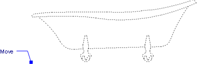

Grips Editing
External references can be edited directly through grips:
  1. Select the xref. Notice that it has one grip at its insertion point.
  2. Drag the grip to move the xref.
