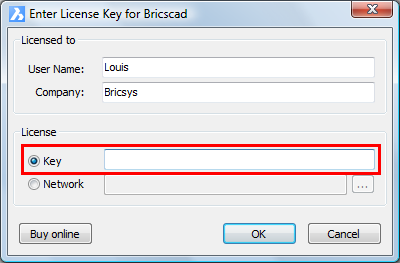

To enter or modify a regular license key
  1. Do one of the following:
The License Information dialog opens.
  1. Click the Modify button on the Lincense Information dialog.
  2. Click the Key radio button on the Enter License Key for BricsCAD dialog.
  3. Type or Copy/Paste your license key in the Key field.
  4. Click the OK button.
NOTE
Depending on the User Account Control Settings on your computer it might be necessary to launch BricsCAD using the Run as administrator option.

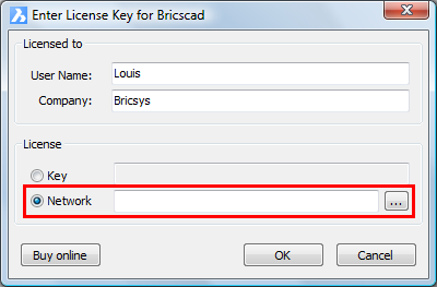

Enter or modify a network license key
  1. Click the Network radio button on the Enter License Key for BricsCAD dialog.
  2. Click the browse button next to the Network field.
  3. Select the Network License File on the network server, then click the Open button.
NOTES
  • It is not possible to lock a key in a Network License File  and migrate it to a machine to run BricsCAD when not connected to the network. (e.g. it is not possible to use it on a laptop when this laptop is not connected to the network).
  • The user on the client machine where BricsCAD is running, has to have write access to the shared network drive where the network license file is placed.
  • A license key with user type 'Network License', does only work when used in a network license file. It can not be entered as a regular license key.
  • If BricsCAD crashes or is shut down without access to the network, then the license key remains locked, until BricsCAD is shut down once on that same machine, with access to the network.

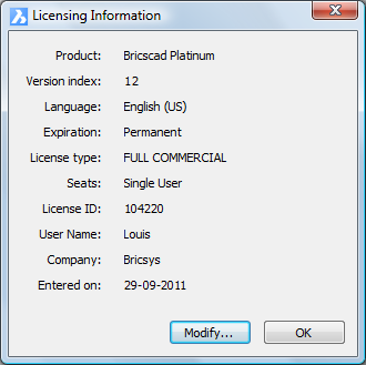

Reading the current license key
To see the current license key, do the following:
  1. Choose License in the Help menu.
  2. Press and hold the Shift and Ctrl keys, then click the Modify button on the Licensing Information dialog box.
