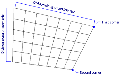

Mesh
Draws 3D meshes; prompts you:
First of four corners for polygon mesh - pick a point, or enter x,y,z coordinates.
Second corner - pick a point, or enter x,y,z coordinates.
Third corner - pick a point, or enter x,y,z coordinates.
Last corner for mesh - pick a point, or enter x,y,z coordinates.
Number of divisions along primary axis (between 2 and 256) - enter a number.
Number of divisions along secondary axis (between 2 and 256) - enter a number.
