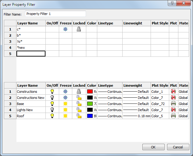

If pressed, displays layers of which the name fits the Filter Text field only:
Displays the current layer filter. Click the down-arrow button to choose a different layer filter. All and All Used Layers are built-in layer filters. Choose All to see all layers in the list; choose All Used Layers to list non-empty layers only. If the drawing contains external references (Xrefs) a layer filter definitions for Xref layers and for each Xref are created automatically. Choose Show XRef Layers in the View menu to display the Xref layers in the Details pane.
To toggle the display of the Filter Panel On/Off do one of the following:
On the Filter Panel:
To create a new layer filter definition:
