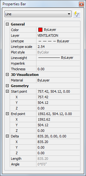

Displays the Properties palette with properties of selected entities.
command bar: properties
aliases: ch, pr, props, mo, ddchprop, ddmodify
menu bar: Modify | Properties
toolbar: Standard |
: properties
Displays a palette with varying content:
When no entities are selected: shows the current entity creation settings.
When one entity is selected: reports the properties of the selected entity.
When two or more entities are selected: reports the shared properties of the selected entities.

Other properties vary, depending on the entity selected.
