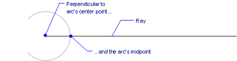

Entity
Draws xlines perpendicular to the midpoint of lines and polyline segments, and the center point of arcs and polyarcs; prompts you:
Select line,arc, or polyline segment to bisect - select a line, an arc, a polyline segment, or a polyarc.
  • Line or polyline segment - draws xline perpendicular to the segment's midpoint:
  • Arc or polyarc - draws xline perpendicular to the arc's center point and through its midpoint:

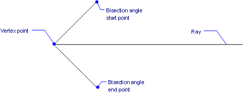

Vertex point
Draws xlines that start at the vertex point and bisect two pick points; prompts you:
Bisection angle start point - specify one part of the bisection angle.
Bisection angle start point - specify the other part of the bisection angle.

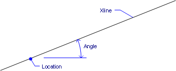

Angle
Draws xlines at angles; prompts you:
Reference/<Enter angle (0)> - enter an option.

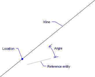

Reference
Draws xlines at an angle relative to another entity; prompts you:
Select reference entity - choose a line.
The line provides the reference (base) angle.
Enter angle - specify the angle, measured relative to the entity.
Location - specify the angle's start point; need not coincide with the entity's end points.
The 'Location' prompt repeats for drawing multiple infinite lines at the same angle.
Enter angle
Specifies the angle; enter an angle or pick two points to indicate the angle.
Prompts you:
Location - specify the starting point of the xline.
