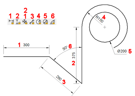

The dimensions of the geometry can be controlled by dimensional constraints:
Horizontal distance between points (1).
Vertical distance between points (2).
Distance between points or the length of lines and polyline segments (3).
Radius of arcs, circles and arc polyline segments (4).
Diameter of arcs, circles and arc polyline segments (5).
Angle between entities or between points and entities (6).

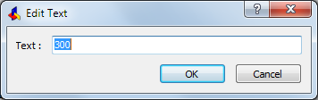

Double click the dimensional constraint.
The command bar reads: _ddedit
The Edit Text dialog box
displays.
Type a new value in the Text field, then press Enter or click the
OK button.
The new value is applied and the geometry is rebuild
accordingly.
displays.
Type a new value in the Text field, then press Enter or click the OK button.

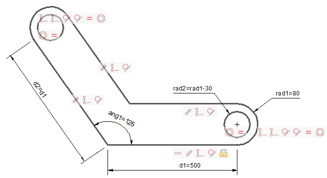

The name of a constraint can be used in a mathematical expression to define another dimensional constraint.
The dimensions of the bracket below are controlled through the rad1 radius, d1 distance and ang1 angular dimensional constraints.
The radius of the hole (rad2) and the length of the second leg (d2) are defined by expressions.
Geometrical constraints force the width of the second leg and the hole in it to be equal to the first leg.
