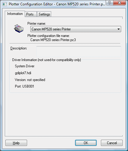

  1. Choose Plotter Manager... in the File menu, then double click Create a Plotter Configuration shortcut ().
The Plotter Configuration Editor dialog opens.

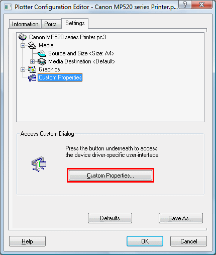

  1. In the Printer name list, select the printer you want to create a plotter configuration (PC3) for.
  2. Click the Settings tab on the Plotter Configuration Editor dialog.
  3. Click the Custom Properties... button.
    The <Selected Printer> Properties dialog opens.
    The layout of this dialog is different for each printer.
    Custom Properties are not supported on the Linux platform.
  4. On the Properties dialog of the selected printer, adjust the printer settings, then click the OK button to confirm.
    The <Selected Printer> Properties dialog closes.

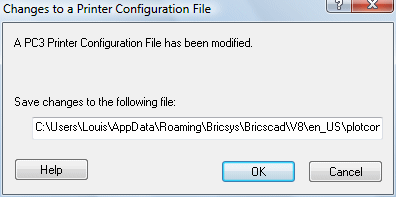

  5. Click the OK button on the Plotter Configuration Editor dialog.
    The Changes to a Printer Configuration File dialog opens.
  6. (option) Adjust the PC3 file name.
    The default name is <Selected Printer>.pc3.
  7. Click the OK button on the Changes to a Printer Configuration File dialog.
    The PC3 file is created.
NOTE
If you want to create multiple plotter configurations for the same printer, you must adjust the default name in step 7. If you accept the default name, the existing plotter configuration will be overwritten.
