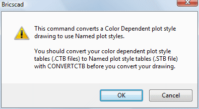

To convert a drawing from CTB to STB file type
  1. Type convertpstyles at the command prompt, then press Enter.
    An alert box displays:
  2. Do one of the following:
  3. Click the Cancel button and convert your CTB files first.
    The drawing is not converted.
  4. Click the OK button.
    The Select style table file dialog displays.
  1. Select a *.stb file created by the CONVERTCTB command, then click the OK button.
    The drawing is converted.
