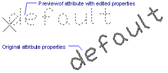

As you change the attribute text, BricsCAD previews them:
