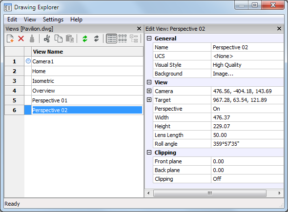

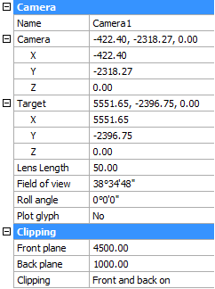

Editing a Camera
Properties of a camera view can be edited:

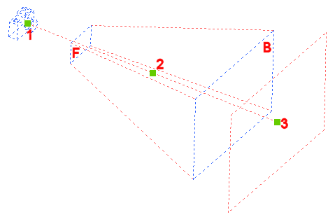

Cameras can be edited directly through grips:
  1. Select the camera glyph in the drawing. Notice that it has three grips.
    Front (F) and back (B) clipping planes display in a blue dotted line.
  3. Position the camera (1).
  4. Move the camera definition as a whole (2).
  5. Position the target (3).
