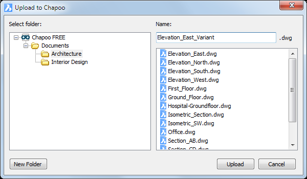

New Folder
Creates a new folder as a subfolder of the currently selected folder.
Upload
Uploads the drawing to the selected folder.

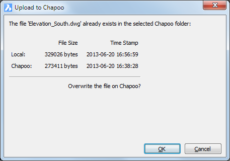

If a drawing of the same name already exists in the selected folder, the drawing is uploaded as a revision of the original drawing. A dialog displays:
