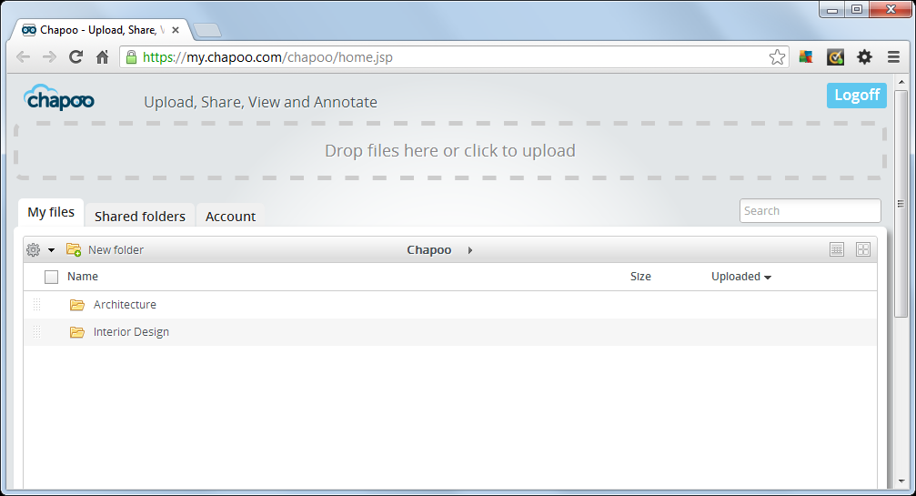

ChapooProject
Opens your Chapoo project in a browser.
command bar:  chapooproject
menu bar:  File | Chapoo | My Chapoo...
toolbar: Chapoo |
: chapooproject
Displays the logon page to Chapoo in a browser.
No Options
