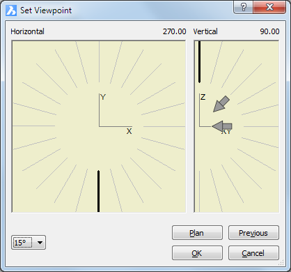

Choose a viewing angle, and then click X.
Vertical
Specifies the vertical angle from the XY plane.
View direction is horizontal.
View direction is 45° down.
This option is not available if Angle Precision = 45°.
View direction is 45° up.
View direction is 45° down, except for 0°, 90°, 180° and 270° horizontal angles, which generate orthographic views: front, back, left and right.
First select the horizontal arrow, then click the 45° down arrow.
View direction is 45° up, except for 0°, 90°, 180° and 270° horizontal angles, which generate orthographic views: front, back, left and right.
First select the horizontal arrow, then click the 45° up arrow.
Click an angle to set the vertical view direction angle.
Horizontal
Specifies the horizontal angle from the X-axis.
Click a preset angle to set the horizontal view direction angle.
Click at 0°, 45°, 90°, 135°, 180°, 225°, 270° or 315°.
The shape of the arrow indicates whether the view is horizontal () or at an angle ().
Angle Precision
Sets markers at 5, 15, or 45 degrees; default = 45.
Plan
Reverts the 3D viewpoint to 2D plan view.
Previous
Reverts to the previous viewpoint.
OK
Sets the viewpoint and exits the dialog box.
