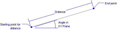

Reports the distance and angle between two points.

Starting point for distance: (Pick a point, or enter coordinates.)
End point: (Pick another point, or enter coordinates.)
Sample response:
Distance = 4.3167,  Angle in XY Plane = 220,  Angle from XY Plane = 0
Delta X = -3.3302,  Delta Y = -2.7466,  Delta Z = 0.0000
