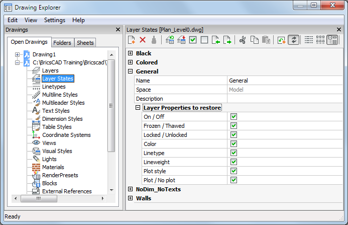

Layer Properties to Restore
Specifies which layer properties are restored when the layer state is restored.
When in Icon View () or Detail View ():
  • Click the On icon () to turn all layer properties on.
  • Click the OFF icon () to turn all layer properties off.
When in Tree View (): Click the check boxes to select a property.
