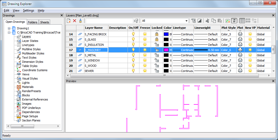

Displays the Layers section of the Drawing Explorer dialog box:
Create layers or modify layer properties, and then click X.

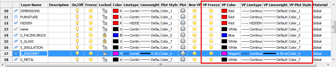

Viewport Layer Properties
When you open the Drawing Explorer - Layers dialog when in paper space, additional columns display: New, VP Freeze, VP Color, VP Linetype, VP Lineweight and VP Plot Style (VP is short for Viewport). By default, these columns match the corresponding model space settings. VP layer properties can be set differently for each layout and for each paper space viewport.
If SHOWLAYERUSAGE is on, the Layer Usage icons indicate whether VP settings for the current layout or paper space viewport are different from the model space settings:
Create or modify VP layer properties, and then click X.
Press F1 to access help.
To remove VP Layer properties overrides:
  1. Select the layer(s), then right click and choose Remove Viewport Overrides in the context menu.

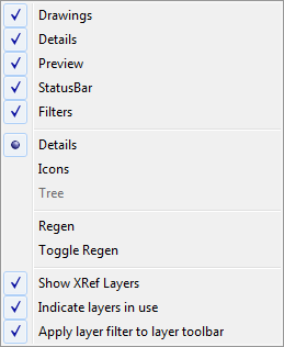

View Menu
Drawings
Toggles the display of the Drawings panel.
Details
Toggles the display of the Details panel.
Preview
Toggles the display of the Preview panel.
StatusBar
Toggles the display of the Status Bar.
Filters
Toggles the display of the Filters panel.
Details
Switches the display in the Details panel to Details view.
Icons
Switches the display in the Details panel to Icons view.
Regen
Forces the drawing display to be regenerated.
Toggle Regen
Toggles the automatic regen of the drawing display.
Show XRef Layers
Toggles the display of Xref layers in the Details panel.
Indicate layers in use
Toggles the SHOWLAYERUSAGE system variable On/Off.
Apply layer filter to layer toolbar
Applies the current layer filter to the Layer control on the Entity Properties toolbar.

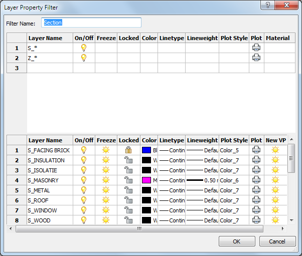

To create a new layer filter definition:
  1. Click the New button () on the Filter Panel toolbar.
    The Layer Property Filter dialog box displays:
  2. Type a name in the Filter Name field.
  3. (option) Type a search string in the Layer Name field (see Filter Text).
  4. (option) Click a property column, then set a filter criterion for this property.
    Multiple properties can have criterion applied.
  5. (option) Repeat steps 3 and 4 for each new row in the layer filter definition.
  6. Click the OK button to save the layer filter.

Layer Name
Specifies the name of the layer.
  • Click in the column, then type a character to jump to the first layer starting with that character.
  • To rename:
  1. Click the name twice, slowly.
  2. Enter the new layer name.
(option) Describes the content of the layer. Click the field, then type.

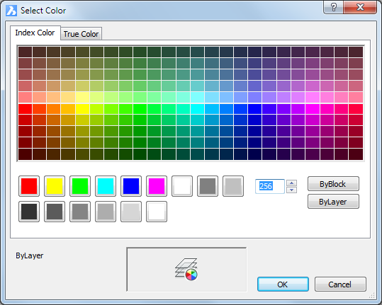

Color
Specifies the color of the layer. Default color is white (black).
To change the color:
1. Click a color square to see the Select Color dialog box.
2. Choose a color, and then click OK.
See Color command.
