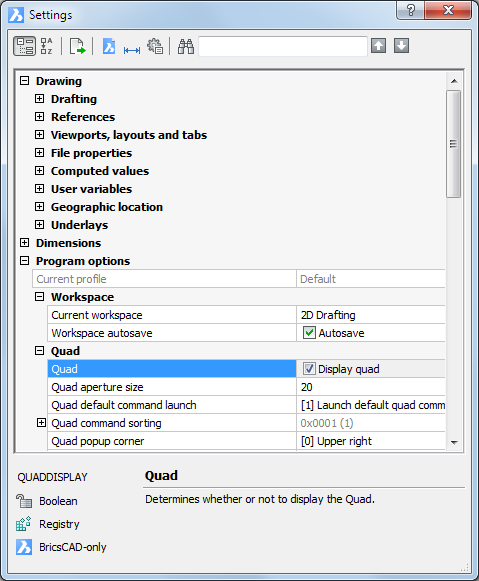

Settings
Changes the values of system variables through a dialog box.
command bar:  settings
aliases:  ddrmodes, rm, options, dsettings, ddsetvar
menu bar:  Settings | Settings
toolbar:  Settings |
: settings
Changes to settings are applied immediately.
Click X to close this dialog box.
Categorized
Lists system variables in categories:
  • Drawing.
  • Dimensions.
  • Program Options.
Alphabetic
Lists system variables in alphabetical order.

 Drawing
Jumps to the Drawing section of the dialog box.
 Dimensions
Jumps to the Dimensions section of the dialog box.
See DimStyle command.
 Program Options
Jumps to the Program Options section of the dialog box.

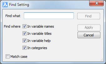

Opens Find Options
Provides additional options for finding system variables.
Displays the Find Setting dialog box:
Find What
Specifies the text to find.
Enter any text, and then click Find.
Find Where
Restricts the search to:
In variable names
Names of system variables, such as "AFLAGS."
In variable titles
Descriptive titles of variables, such as "Attribute options."
In variable help
Help text for system variables, such as "Sets default values for attribute creation."
Match case
Toggles case matching:
Yes - matches the case. For instance, "AFLAGS" must be all uppercase.
No - does not match the case. For instance, you can search for "aflags" or "AFlags."
Find
Finds the text entered in the Find What box.
Apply
Applies changes made to options.

When settings are exported by the Export option, the contents of the CSV file looks like this:
Name,Save mode,Save type,Restype,Default value,Current value,Status,Title
ACADLSPASDOC,reg,bool,RTSHORT,0,0,,on_start.lsp for each doc
ACADVER,not,str,RTSTR,,17.0 BricsCAD,read only,AutoCAD version
ACISOUTVER,not,int,RTSHORT,,16,read only,Acisout version
AFLAGS,not,int,RTSHORT,0,0,,Attribute options
ANGBASE,drw,real,RTREAL,0,0,,Angle base
