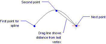

Second point
Specifies the first vertex of the spline.
Next point
Specifies the next vertex.
This prompt repeats until you press Enter.

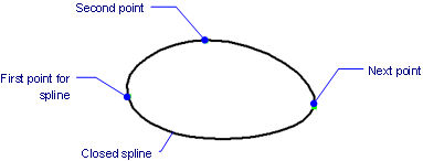

Close
Closes the spline; the end and start points are joined.

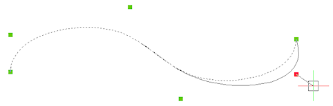

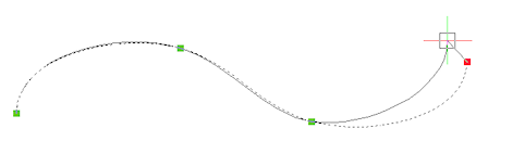

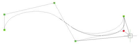

Open and closed splines can be edited directly through grips. Splines can be grip edited either with fit points or control vertices. Choose either Fit or Control vertices from the Method property options of a spline in the Properties Bar. The CV Frame property of the spline controls whether the control vertices frame displays or not.
Method = Fit
Method = Control Vertices; CV Frame = Off
Method = Control Vertices; CV Frame = ON
  1. Select the spline. Notice that it has one grip at each fit point or control vertex.
  2. Drag a grip to stretch the spline.
