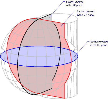

Creates section planes of 3D solids; the results are region entities.

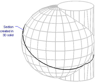

Section made in the current view plane:
Sections are made of regions, and can be manipulated as independent entities:

XY
Creates a section parallel to the x,y plane; prompts you:
Specify a point on the XY-plane - pick a point to define the height of the section above or below the x,y plane.
YZ
Creates a section parallel to the y,z plane; prompts you:
Specify a point on the YZ-plane - pick a point to define the height of the section above or below the y,z plane.
ZX
Creates a section parallel to the z,x plane; prompts you:
Specify a point on the ZX-plane - pick a point to define the height of the section above or below the z,x plane.
