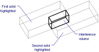

Create interference solids?
Determines whether a solid or region of the interference is created:
  • Yes - creates a solid of the interference volume or region of the interference area.
  • No - does not create solids or regions of the interference.
The solid or region remains after the command ends.

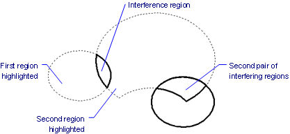

Highlight pairs of interfering solids?
Determines whether solids or regions are highlighted:
  • Yes - highlights the solids and/or regions that interfere with each other.
  • No - does not highlight the entities.

Region - creates 2D regions from 2D entities.
