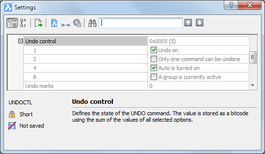

The Undo control settings are stored in the UNDOCTL system variable, which is saved as a bitcode using the sum of the values of all selected options.
In BricsCAD four options are available:
By default UNDOCTL=5. Since the value of UNDOCTL is not saved, the value is reset to the default with each BricsCAD session.
In AutoCAD two more options exist:
BricsCAD behaves as if those options are ON.
