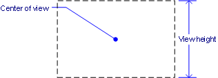

Center
Zooms in or out about a specified center point; prompts you:
Center of view - pick a point or enter x,y coordinates.
Enter zoom factor (nX/nXP), or view height - enter a zoom factor or view height.
The view height defines the zoom; it is the height of the current viewport.

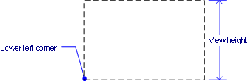

Left
Zooms in or out with the lower left corner specified by a point; prompts you:
Lower left corner - pick a point or enter x,y coordinates.
