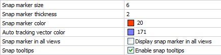

Define the Entity
Snap settings.
User Preference |
Title |
SnapMarkerSize |
Snap marker size |
Sets the size of the snap marker. (default size is 6) |
SnapMarkerThickness |
Snap marker thickness |
Sets the thickness of the snap marker. (default thickness is 2) |
SnapMarkerColor |
Snap marker color |
Sets the color of the snap marker. (default color = 20) |
DisplaySnapMarkerInAllViews |
Snap marker in all views |
If multiple viewports are open, enables the display of the snap marker in all viewports. |
DisplayTooltips |
Snap tooltips (3) |
Enables the display of the Entity Snap tooltips. |

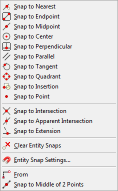

Do one of the following:
Click the buttons on the Entity Snaps toolbar.
The buttons of the currently active entity snap modes are
pressed.
Press and hold the Shift key, then right
click and select the Entity Snap mode in the context menu.
The icons of the currently active Entity Snap modes are
outlined.
When no command is active, the above procedures toggle the Entity Snap modes on/off.
When a command is active, the above procedures set a 'one shot' override of the current Entity Snap modes.
Alternatively you can type a single letter shortcut as indicated in the table below.

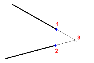

To snap to the extension of two entities
If not already on, turn on the Extension Entity Snap mode (
Launch a drawing tool, e.g. Draw Line.
Move the cursor over the endpoint of the first
entity (1).
A small cross (
) indicates the entity is
marked for extension.
Move the cursor over the endpoint of the second
entity (2).
A small cross (
Move the cursor near the intersection of the
extensions of the two entities.
An X indicates the intersection (3).
Click to accept the snap point.
NOTE |
You can snap to the extension of lines, polylines, arcs and elliptical arcs |
