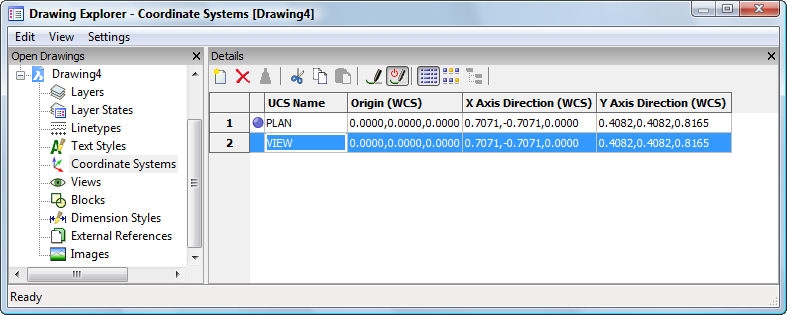

Creates, modifies, and deletes named UCSs through the Drawing Explorer (short for "explore user-defined coordinate systems").
command bar: expucs
alias: uc, dducs, explorer
menu bar: Tools | Drawing Explorer | Coordinate Systems
: expucs
Displays the UCS section of the Drawing Explorer dialog box:
Create or modify named UCSs, and then click X.
Press F1 to access help.
Lists the names of UCSs in the drawing; click to rename. UCS is short for "user-defined coordinate system." |
Reports the origin (0,0,0) of the UCS in x,y,z coordinates of the WCS; cannot be edited. WCS is short for "world coordinate system." |
Reports the direction of the x axis in WCS coordinates; cannot be edited. |
Reports the direction of the y axis in WCS coordinates; cannot be edited. |
Indicates the current UCS. |
New |
Creates a new UCS; dismisses the Drawing Explorer, and then runs the Ucs command. See Ucs command. |
Erase |
Deletes the selected UCS; the current UCS cannot be erased. |
