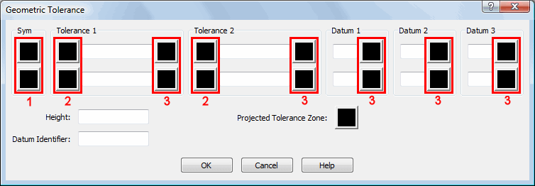

The Geometric Tolerance dialog opens.
  1. Compose the geometrical tolerance frame in the Geometric Tolerance dialog.
  2. Click the OK button.
    The Geometric Tolerance dialog closes.
  3. Click to insert the geometric tolerance frame in the drawing.
  1. Geometric Tolerance Symbol buttons.
    Click to open the Symbol palette.
  2. Diameter Symbol option buttons.
    Click to add the diameter symbol.
  3. Material Condition buttons.
    Click to open the Material Condition palette.
