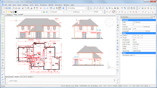

External References (elevations) display faded: XDWGFADECTL + 50

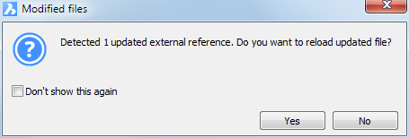

The XNOTIFYTIME system variable defines the frequency to check for modified externally referenced resources: xrefs, images and pdf attachments if XREFNOTIFY, IMAGENOTIFY and/or PDFNOTIFY  is ON.
The XREFNOTIFY system variable controls whether warnings for missing or modified xrefs are issued.
