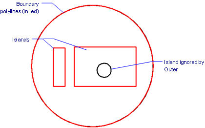

Boundary set |
Specifies the entities to consider for creating boundaries: Specify candidate set for boundary - enter E or N.
Island detection |
Toggles whether islands are hatched over or not: Do you want island detection? - enter an option.
eXit |
Returns to the original prompt. |
