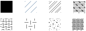

Examples of hatch patterns.

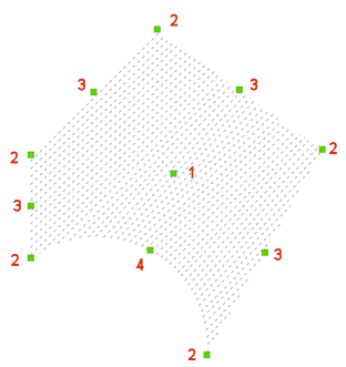

Grips Editing
Hatches can be edited directly through grips:
1. Center grip: moves the hatch
2. Vertex grip: moves the vertex
3. Midpoint grip: moves the boundary segment
4. Arc midpoint grip: modifies the arc radius
