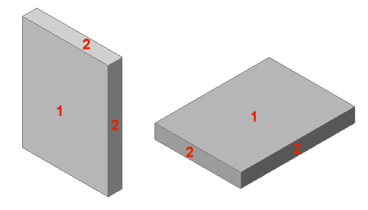

Major faces (1) and minor faces (2).
Major faces
