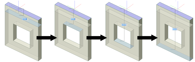

Adds or removes volume from a solid by moving a face.
command bar: dmpushpull
menu bar: Model | Direct Modeling | Push/Pull
toolbar: Direct Modeling |
: dmpushpull
Select faces to push/pull: (select one or more faces on the same or different solids; press and hold the TAB key to select hidden geometry. Press Enter to stop selecting geometry.)
The selected geometry is edited dynamically.
Do one of the following:
Specify a point.
Type a value in the dynamic entry field.
Hit the TAB key to select a different reference face. The current
reference face highlights. All faces which are parallel to the face
being pushpulled are recognized, the nearest first. Press and hold
the Shift key when hitting the TAB key to cycle reference faces in
reverse order.
Planar faces |
The faces are moved, thus adding or removing volume from the solid(s). The value of the movement vector displays in the dynamic entry field. |
Cylindrical and spherical faces |
Edits the radius. The current radius displays in the dynamic entry field. |
Toroidal faces |
Edits the tube radius of the torus. The current radius displays in the dynamic entry field. |
