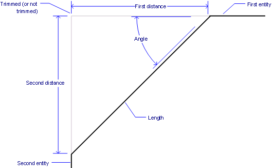

Selects the first entity to be chamfered. Only open entities can be chamfered, with one exception: vertices of closed polylines can be chamfered with the Polyline option. This command cannot place a chamfer between two polylines,but it can place a chamfer between a line and a polyline, even a closed polyline. |
Selects the second entity. The two entities need not meet, but cannot be parallel to each other. |

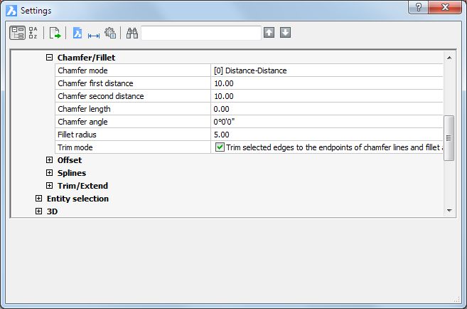

Displays the Settings dialog box for changing chamfer parameters.

Prompts you for the Chamfer length and Chamfer angle in the command bar and sets the Chamfer mode to Length-Angle. |
Prompts you for the Chamfer first distance and Chamfer second distance in the command bar and sets the Chamfer mode to Distance-Distance. |

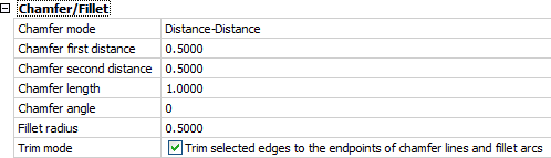

Setting |
Chamfer Mode |
Determines how the chamfer is created:
Chamfer First Distance |
Specifies the default value of the first chamfer distance. |
Chamfer Second Distance |
Specifies the default value of the first second distance. |
Chamfer Length |
Specifies the default length of the chamfer. |
Chamfer Angle |
Specifies the default angle of the chamfer. |
Trim Mode |
Toggles whether intersecting entities are trimmed:
