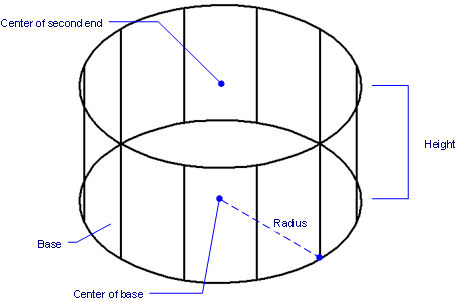

Elliptical/<Center of base of cylinder> <0,0,0>: (Enter coordinates, pick a point, or enter E.)
Diameter/<Radius of cylinder>: (Enter a distance, pick a point, or enter D.)
Center of second end/<Height of cylinder>: (Enter a distance, pick two points, or enter C.)

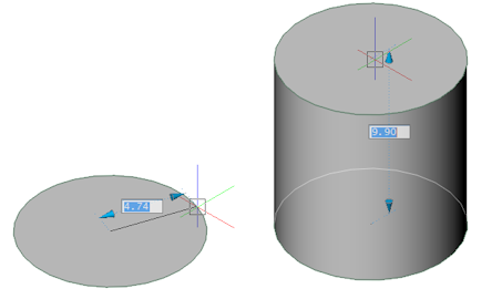

If Dynamic Dimensions are active, you can enter the dimensions in the dynamic dimensions entry fields.
Specifies the center point of the cylinder's base; enter x,y,z coordinates or pick a point in the drawing. |
Draws the cylinder with an elliptical base. |
Specifies the end point of the ellipse's first axis. |
Specifies the other end of the ellipse's first axis. |
Specifies the endpoint of the ellipse's second axis. |
Specifies the radius of the cylinder; enter coordinates, a distance, or pick a point. |
Specifies the radius of the cylinder; prompts you: Diameter of cylinder - enter coordinates, a distance, or pick a point. |
Specifies the height of the cylinder; you can enter a negative number to draw the cylinder downwards. |
Specifies the center point of the cylinder's other end; prompts you: Center of second end - pick a point, or enter coordinates. This option allows you to draw the cylinder rotated at an angle. |
Grips Editing
Cylinders can be edited directly through grips:
Select the cylinder. Notice that it has two grips.
Drag a grip to move the cylinder. (Both grips perform the same function: move.)
