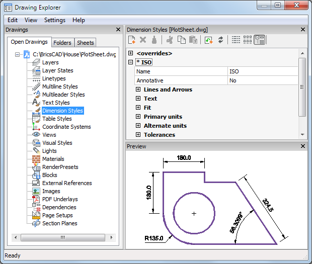

: dimstyle

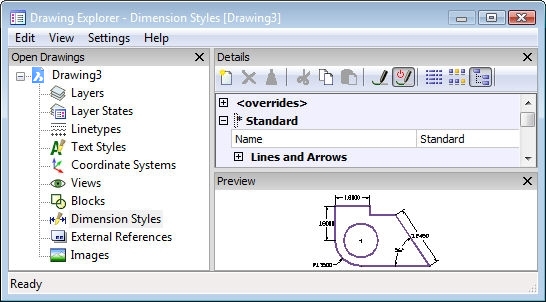

Displays the Drawing Explorer at the Dimension Styles section:
Create or edit dimension styles, and then click X.
Press F1 to access help.
<Overrides> - allows dimension settings to be overriden, without creating a new style.
*Standard - lists the dimension settings for the dimension style named "Standard"; the * asterisk indicates that this is the current style.
Names of the dimension style; all styles can be renamed and deleted, except for the Standard style. |

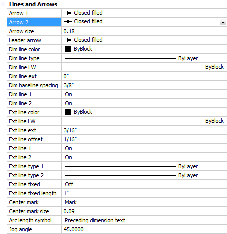

Arrow 1 |
Specifies the style of arrowhead for the starting end of the dimension line; choose from one of the following types:
Arrow 2 |
Specifies the style of arrowhead for the other end of the dimension line. |
Arrow Size |
Specifies the length of the arrowhead; the width is scaled proportionately. |
Leader Arrow |
Specifies the style of arrowhead for the starting end of the leader line. |
Dim Line Color |
Specifies the color of the dimension line; choose from:
Dim Line type |
Specifies the line type of the dimension line; choose from any line type loaded into the current drawing. To access additional linetypes, click Load, and then choose one from the Load Linetypes dialog box. |
Dim Line LW |
Specifies the lineweight of the dimension line; choose from any lineweight supported by BricsCAD. |
Dim Line Ext |
Specifies the distance that the dimension line extends beyond the extension lines. |
Dim Baseline Spacing |
Specifies the default distance between dimensions added with the DimBaseline command. |
Dim Line 1 |
Toggles the display of the first half of the dimension line (between the starting extension line and the text). |
Dim Line 2 |
Toggles the display of the second half of the dimension line (between the other extension line and the text). |
Ext Line Color |
Ext Line type |
Specifies the line type of both extension lines; choose from any line type loaded into the current drawing. To access additional linetypes, click Load, and then choose one from the Load Linetypes dialog box. |
Ext Line LW |
Specifies the lineweight of the extension line; choose from any lineweight supported by BricsCAD. |
Ext Line Ext |
Specifies the distance that the extension lines extend beyond the dimension line. |
Ext Line Offset |
Specifies the offset distance between the object and the start of the extension lines. |
Ext Line 1 |
Toggles the display of the first extension line. |
Ext Line 2 |
Toggles the display of the second extension line. |
Ext line type 1 |
Specifies the line type of the first extension line; choose from any line type loaded into the current drawing. To access additional linetypes, click Load, and then choose one from the Load Linetypes dialog box. |
Ext line type 2 |
Specifies the line type of the second extension line; choose from any line type loaded into the current drawing. To access additional linetypes, click Load, and then choose one from the Load Linetypes dialog box. |
Ext line fixed length |
Specifies the length of fixed-length extension lines. |
Center Mark |
Specifies the type of center mark:
Center Mark Size |
Specifies the size of the center mark. |
Arc length symbol |
Specifies the location of the arc length symbol:
Jog angle |
Specifies the angle of the jog; default is 45 degrees. Enter another angle. |

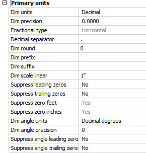

Dim Units |
Specifies the display units for dimensions:
Dim Precision |
Specifies the precision of units, either decimal places or fractional accuracy. |
Fractional Type |
Specifies how fractions are stacked:
Decimal Separator |
Specifies the character used to indicate the decimal point; can be any character. North American countries use the period; European countries use the comma. |
Dim Round |
Specifies the rounding of decimal numbers; range is none to 8 decimal places. |
Dim Prefix |
Specifies prefix text that appears in front of the dimension text, if any. |
Dim Suffix |
Specifies suffix text that appears after the dimension text, if any. |
Dim Scale Linear |
Specifies the multiplier for dimension values, such as 25.4 for changing inches to millimeters. |
Suppress Leading Zeros |
Toggles the display of zeros in front of the decimal point; for example, 0.23 is displayed as:
Suppress Trailing Zeros |
Toggles the display of zeros in front of the decimal point; for example, 1.2300 is displayed as:
Suppress Zero Feet |
Toggles the display of zero feet; for example, 0'-3" is displayed as:
Suppress Zero Inches |
Toggles the display of zero inches; for example, 1'-0" is displayed as:
Dim Angle Units |
Specifies the format of units in angular dimensions:
Dim Angle Precision |
Specifies the number of decimal places; ranges from 0 to 8. |
Suppress Angle Leading Zeros |
Toggles the display of zero degrees; for example, 0.1234 degrees is displayed as:
Suppress Angle Trailing Zeros |
Toggles the display of zeros after degrees; for example, 0.1200 degrees is displayed as:

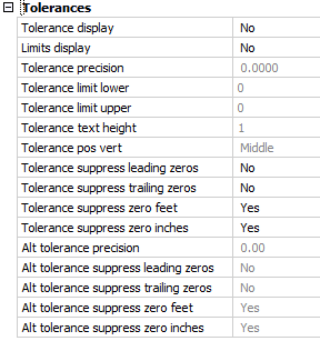

Tolerance Display |
Toggles the display of tolerance text. |
Tolerance Precision |
Specifies the display precision of tolerance text; range is 0 to 8 decimal places or 1/1 to 1/256 inch. |
Tolerance Limit Lower |
Specifies the value of the upper tolerance. |
Tolerance Limit Upper |
Specifies the value of the lower tolerance. |
Tolerance Text Height |
Specifies the height of tolerance text. |
Tolerance Pos Vert |
Locates the tolerance text relative to the dimension text:
Tolerance Suppress Leading Zeros |
Toggles the display of zeros in front of the decimal point. |
Tolerance Suppress Trailing Zeros |
Toggles the display of zeros behind the decimal point. |
Tolerance Suppress Zero Feet |
Toggles the display of zero feet. |
Tolerance Suppress Zero Inches |
Toggles the display of zero inches. |
Alt Tolerance Precision |
Specifies the number of decimal places for tolerances in alternate units. |
Alt Tolerance Suppress Leading Zeros |
Alt Tolerance Suppress Trailing Zeros |
Alt Tolerance Suppress Zero Feet |
Alt Tolerance Suppress Zero Inches |
