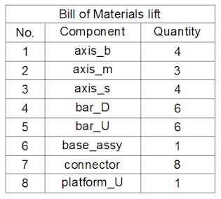

Top level
Creates a BOM of the top level components only.

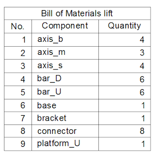

Bottom level
Creates a BOM of the subcomponents.
Compared to the Top Level BOM, the base_assy component is broken up into the base and bracket components.

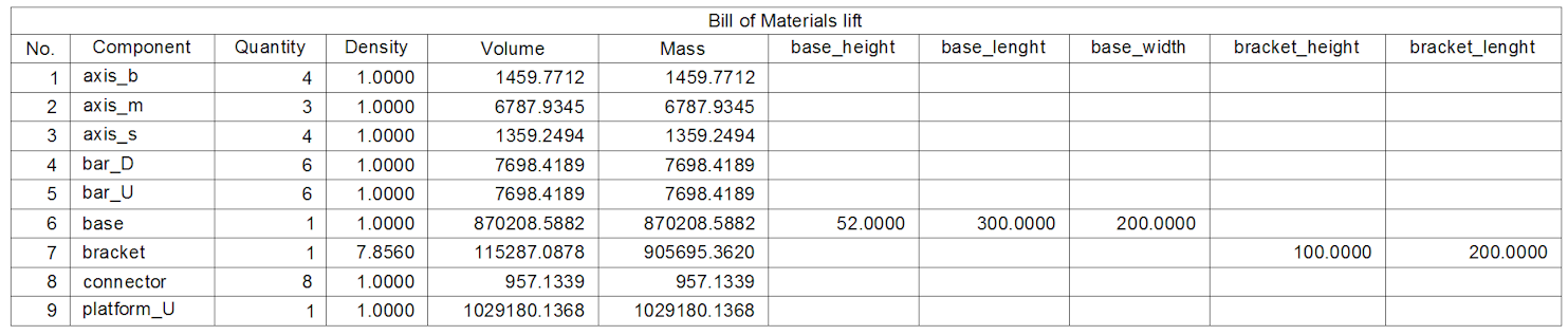

Configure
Allows to add additional columns to your BOM table: Description, Density, Volume, Mass, and Parameters (for parametric components).
Prompts you:
Toggle columns [Description/dEnsity/Volume/Mass/parameterS/Back] <Back>:
Choose an option:
  • Description: adds the Description column.
  • Density: adds the Density column.
  • Volume: adds the Volume column.
  • Mass: adds the Mass column.
  • Parameters: If several inserts of the same parametric component exist in the assembly they will be grouped in different BOM rows depending on the values of their parameters.
  • Back: Returns to the previous prompt.
BOM with Densitiy, Volume, Mass and Parameters
