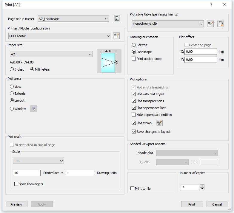

Print
Prints drawings to plotters and files through a dialog box.
command bar:  print
shortcut:  Ctrl+P
menu bar:  File | Print
: print
Choose options, and then:
click Preview to preview the plot on simulated paper.
click Apply to apply the changes.
click Print to print the drawing.
click Cancel to close the Print dialog box.
Page setup name:
Recalls plot settings used previously:
  • None - uses options saved in the current layout or model space.
  • Previous Plot - uses options that were saved from the last time this dialog box was used.
  • Page Setup - lists the named page setups in the drawing.
Click the Save current settings to page setup button () to create a new page setup (see the PageSetup command).

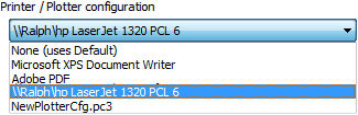

Printer/Plotter Configuration
Selects the printer or plotter. BricsCAD works with any output device installed on the system, including networked printers, print to file, faxes, and PostScript devices.
In addition, BricsCAD uses predefined printer parameters stored in PC3 files. See PlotterManager command.
Edit plotter configuration
Opens the printer's Properties dialog box for customizing the printer's parameters.

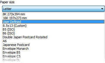

Paper Size
Chooses the size of paper. You can select standard sizes listed by the droplist; these are sizes supported by the printer.
While printer may appear to support many different sizes, you should select only the size of paper that is actually in the printer. If User Defined appears in the list, the paper's dimensions are specified by the printer's Properties dialog box.
The image indicates the size, position and orientation of the current plot area on the selected paper size.
Units
Switches paper measurements between imperial and metric.
Plot Area
Specifies which area of the drawing to print:
  • View - prints the current view or a named view. See View command.
Choose a view from the droplist:
  • Extents - prints the extents of the drawing, which ensures every visible entity is printed.
Entities on frozen layers are not taken into account when calculating the extents.
  • Limits - prints the limits of the drawing, as specified by the Limits command.
  • Window - prints a rectangular area of the drawing.
You define the rectangular area by entering x,y coordinates or by clicking the Select Area to be Printed button.
Select area to be printed
Specifies the rectangular area to be printed. Click the button; the dialog box is dismissed temporarily, and you are prompted:
Select first corner of window - specify one corner of the rectangle.
Select second corner of window - specify the other corner.
You can pick points or enter x,y coordinates.
The Print dialog box returns, with the pair of x,y coordinates added to the Windows Plot Area boxes.
Specifies the x,y coordinates of the lower-left and upper-right corners of the rectangular area to be printed. You can enter x,y coordinates, or click the button to pick points in the drawing.
Plot Scale
Scales the drawing so that it fits the printable area of the paper.
The scale is calculated automatically by BricsCAD, and takes into account the print area of the drawing.
The printable area is the size of the paper, minus the margins.
The margins are the strips along the four edges that the printer uses for handling the paper.
When this option is turned on, you cannot specify the scale factor.
Specifies the scale factor of the printed drawing.
Choose a scale factor from the droplist, or select Custom to specify a scale factor.
Available scales in the list can be edited using the ScaleListEdit command.
For scale factors like 1:5, the drawing is scaled smaller.
For scale factors like 5:1, the drawing is scaled larger.
When printing Model Space page setups:
Specifies user-defined scale factors.
For example, to print a drawing of 50'-long house on paper 11" wide, enter:
Printed Inches = 11"
Drawing Units = 50'
BricsCAD works out the scale factor automatically.
When printing a Paper Space layout:
The Scale setting specifies the relation between paper units and drawing units. Paper units are either inches or millimeters. Drawing units can be feet, centimeters, meters, ...
Scale setting when drawing units are feet:
Scale setting when drawing units are cm:
