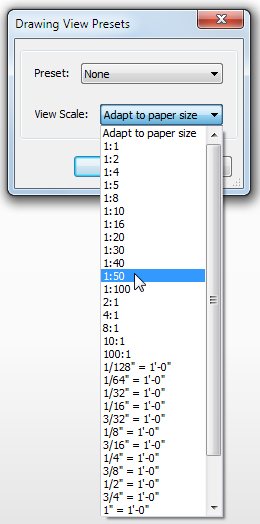

Presets
Allows to select a preset, which controls the number of generated drawing views and their placement in the layout.
The selected preset is saved through the DRAWINGVIEWPRESET system variable.
Click the Preset button to select a preset. The options are:
  • None
  • Architectural Views: generates  Front, Right, Back, Left (elevations) and Top views  and 3 section views: two horizontal sections (plans) and 1 vertical section.
  • Mechanical Views: generates three standard views: Front, Top and Left (first angle projection) or right (third angle projection). The layout is controlled by the projection type: first or third angle. The current projection type is saved through the PROJECTIONTYPE system variable.
Click the View Scale button, then select a scale. The scale list can be edited by the SCALELISTEDIT command.

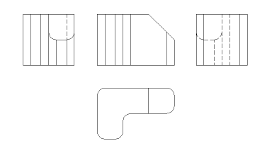

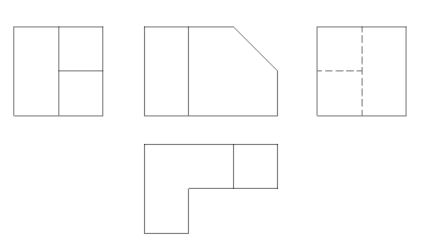

Tangent Edges
Defines whether tangent edges between tangent faces display or not.
Prompts you:
Enable tangent edges on basic views? [Yes/No/Exit] <No>:
NO:
Yes:

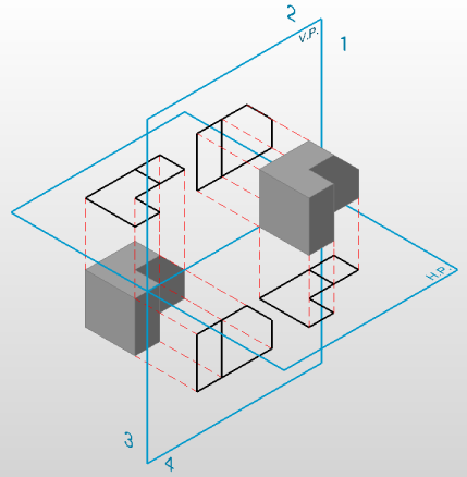

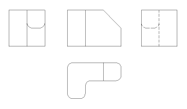

Projection type
Defines the layout of the views.
Prompts you:
Select the projection type [First angle/Third angle/Exit] <First angle>:
First Angle or European projection:
Third Angle or American projection:

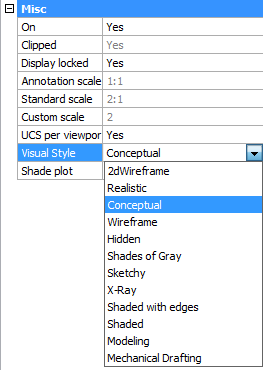

Enable conceptual visual style for isometric views? [Yes/No/Exit] <No>:
  • Yes: Isometric views use the Conceptual visual style.
    Optionally, choose a different visual style for the viewport in the Properties Bar.
  • No: Isometric views are 2D drawings.
