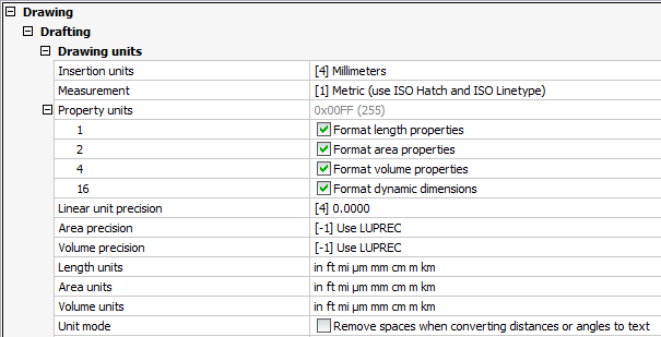

Insertion Units |
Defines the value of 1 Drawing Unit (DU), which is used for automatic scaling when inserting or attaching blocks, images or Xrefs. When both INSUNITS and PROPUNITS are ON, Length, Area, Volume and/or Inertia properties will be formatted with a dedicated unit. |
MEASUREMENT |
Measurement |
Sets drawing units as Imperial or Metric. The MEASUREMENT system variable controls whether ANSI or ISO hatch pattern and linetype files are used. |
Property Units |
Defines which property values are automatically formatted with a dedicated unit when INSUNITS is not zero. The value is stored as a bitcode, using the sum of the values of all selected options: 1 = format lengths 2 = format areas 4 = format volumes 16 = format dynamic dimensions |
Linear Unit Precision |
Sets the number of decimal places displayed for linear units. |
Area Precision |
Sets the number of decimal places displayed for areas when the Area bit of PROPUNITS is ON. If set negative, the value of LUPREC is used. |
Volume Precision |
Sets the number of decimal places displayed for volumes when the Volume bit of PROPUNITS is ON. If set negative, the value of LUPREC is used. |

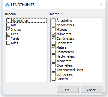

Length Units |
Defines a list of units used for displaying lengths when the Length bit of PROPUNITS is ON. If empty, all lengths display in the current drawing unit, as defined by INSUNITS. If multiple units are selected, the unit that fits best is used.

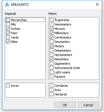

Area Units |
Defines a list of units used for displaying areas when the Area bit of PROPUNITS is ON. If empty, all lengths display in the current drawing unit, as defined by INSUNITS. If multiple units are selected, the unit that fits best is used.

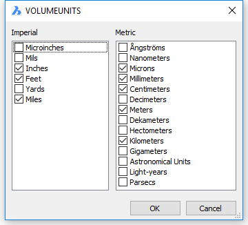

Volume Units |
Defines a list of units used for displaying volumes when the Volume bit of PROPUNITS is ON. If empty, all lengths display in the current drawing unit, as defined by INSUNITS. If multiple units are selected, the unit that fits best is used.
