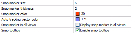

To define the Entity Snap settings
Under Drawing expand the Drafting settings group then go to Coordinate Input > Entity Snaps.
Define the Entity
Snap settings.
User Preference |
Title |
SnapMarkerSize |
Snap marker size |
Sets the size of the snap marker. (default size is 6) |
SnapMarkerThickness |
Snap marker thickness |
Sets the thickness of the snap marker. (default thickness is 2) |
SnapMarkerColor |
Snap marker color |
Sets the color of the snap marker. (default color = 20) |
DisplaySnapMarkerInAllViews |
Snap marker in all views |
If multiple viewports are open, enables the display of the snap marker in all viewports. |
DisplayTooltips |
Snap tooltips (3) |
Enables the display of the Entity Snap tooltips. |
System Variable |
Title |
OSMODE |
Entity snap mode |
Sets the entity snap modes and toggles entity snap on/off. |
APBOX |
Entity snap aperture box |
Toggles the display of the aperture box (2). |
APERTURE |
Entity snap aperture |
Sets the size of the Autosnap aperture box. (default size is 10) |
OSNAPZ |
Ignore entity snap elevation |
Replaces the Z-coordinate of the snapping point with the current value of the ELEVATION system variable. |
PDFOSNAP |
Pdf entity snap |
Enables snapping to the geometry in pdf underlay files. |

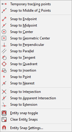

Do one of the following:
When no command is active, the above procedures toggle the Entity Snap modes on/off.
When a command is active, the above procedures set a 'one shot' override of the current Entity Snap modes.
Alternatively you can type a single letter shortcut as indicated in the table below.
Name |
Icon |
Marker |
Context |
Transparent shortcut** |
TK |
tk |
Use temporary tracking points. Prompts you to identify temporary points; press Enter to accept the last temporary point. |
2 |
mtp |
Snaps to a point in the middle between two points. Prompts you to identify two points. |
E |
end |
Snaps to the nearest endpoint of an entity or polyline segment. |
M |
mid |
Snaps to the midpoint of an entity or polyline segment. |
N |
nea |
Snaps to the nearest point on an entity. |
C |
cen |
Snaps to the center point of an arc, circle, polygon, ellipse or elliptical arc. Snaps to the center of gravity of a closed polyline. |
G |
gce |
Snaps to the centroid of any closed polylines and splines, planar 3d polylines, regions and planar faces of 3D solids. |
P |
per |
Snaps to the perpendicular point of another entity. You can snap to an arc, circle, ellipse, line, polyline, infinite line, ray, spline or edge of a plane to form a perpendicular alignment with that entity or with an extension of that entity. |
L |
par |
Displays a tracking line parallel to the selected entity. |
T |
tan |
Snaps to the point on an arc, ellipse, spline or circle that, when connected to the previous point, forms a line tangent to that entity. |
Q |
qua |
Snaps to the closest quadrant of an arc, circle, ellipse, or elliptical arc. |
I |
ins |
Snaps to the insertion point of an attribute, block or text entity. |
O |
poi nod |
Snaps to a point entity. |
R |
int |
Snaps to the intersection of any combination of entities. |
A |
app |
Snaps to the apparent intersection in the current view of two entities that do not intersect in three-dimensional space. |
X |
ext |
Snaps to the extension of an entity or to the intersection of the extension of two entities. |
Y |
non |
Turns off all entity snap modes. |
* Type this letter to quickly select the entity snap mode in the right click context menu.
** Type the transparent shortcut in the command bar when a command prompts for a point. Other running entity snaps are temporarily disabled.
System Variable |
Icon |
OSNAPZ |
Ignore entity snap elevation: replaces the Z coordinate of the snapped point with the current value of the ELEVATION system variable. |
OSOPTIONS |
Entity snap to hatches: allows to snap to hatches. |
OSOPTIONS |
Entity snap to negative-z: allows entity snaps with a negative z-value when a Dynamic UCS is active, |
OSOPTIONS |
Entity snap ignores the endpoint of dimension extension lines closest to the extension line origin point. |

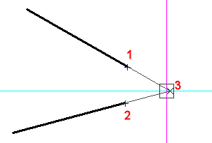

To snap to the extension of two entities
NOTE |
You can snap to the extension of lines, polylines, arcs and elliptical arcs |
