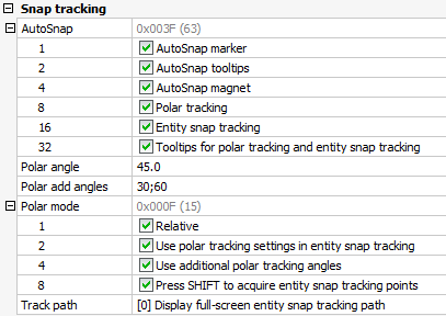

To define the Polar Tracking settings
  1. Do one of the following:
  2. Right click on the POLAR  field in the Status Bar, then right click and choose Settings in the context menu.
  3. Open the Settings dialog, then expand the Coordinate input sub-category under Drafting in the Drawing settings class.
    Expand the
    Snap Tracking settings group.
  1. Adjust the settings:
  2. 1: Autosnap marker (not used, required for AutoCad® compatibility only)
  3. 2: Autosnap tooltips (not used, required for AutoCad® compatibility only)
  4. 4: Autosnap magnet (not used, required for AutoCad® compatibility only)
  5. 8: If checked, Polar Tracking is on.
  6. 16: If checked, Object Snap Tracking is on.
  7. 32: If checked, tooltips display for polar tracking and entity snap tracking.
  8. Polar angle: Sets the polar angle increment.
  9. Polar add angles: Sets the additional polar angles. Separate angles by semicolons.
  10. 1: If checked, polar angles are measured relatively from selected entities.
  11. 2: If checked, the polar angles (interval and additional angles) are also used in entity snap tracking.
  12. 4: If checked, the additional angles for polar tracking are used.
  13. 8: If checked, press and hold the Shift key to acquire entity tracking points.
  14. Track path: Controls the display of the polar and entity snap tracking paths.
