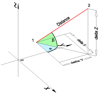

The following information displays in the command
bar (see image below):
Distance, Angle in XY Plane (alpha), Angle from XY
Plane (beta),
Delta X, Delta Y, Delta Z.
The values are calculated with respect to the
current coordinate
system.
