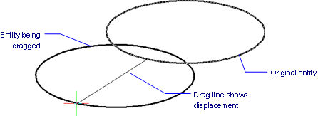

[ON/OFf/Auto] <Auto>: (Enter an option.)
ON
Turns on dragmode; same as Auto mode.
OFF
Turns off dragmode; dragged objects and the dragline are never shown on the screen.
Auto
Turns on drag mode; dragged objects are always shown.
