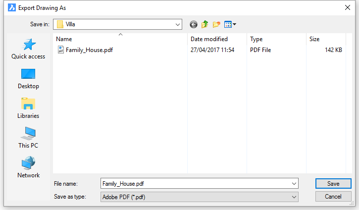

Displays a file dialog box:
Type a name in the File name field or accept the default name (<DrawingName>.pdf), then press the Save button.

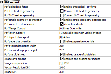

The options for PDF export can be found in the PDF export group in the Settings dialog or in the Pdf Options on the Publish dialog.
Pdf embedded fonts
Enables embedding of True Type fonts in the generated Pdf file.
Pdf TTF text as geometry
Enables the conversion of True Type font texts to geometry.
Pdf SHX text as geometry
Enables the conversion of SHX font texts to geometry.
Pdf simple geometry optimization
Enables simple geometry optimization: unify separate segments to one polyline; use of Bezier curve control points.
Pdf zoom to extents mode
When OFF use the scale and papersize of the page setup.
When ON zoom the layout geometry to the papersize.
Pdf Merge Control
Controls the appearance of crossing lines.
0 - Lines Overwrite: The top most line is visible at the intersection.
1 - Lines Merge:  The colors of crossing lines are blended into a new color.
Pdf layer support
Controls the use of layers in the generated Pdf file.
0 - Do not use layers.
1 - Only use visible layers.
2 - Use all layers, including OFF and FROZEN layers.
Pdf layouts to export
Controls which layouts are exported.
0 - Active layout only.
1 - All layouts in a single multi-sheet pdf file.
2 - Each layout in a separate single-sheet pdf file.
Pdf papersize override
Enables papersize override.
Pdf overridden paper width
Pdf width to be used in the papersize override in millimeters.
Pdf overridden paper height
Pdf height to be used in the papersize override in millimeters.
Pdf use plotstyles
Enables the usage of plotstyles.
Image anti-aliasing
Enables anti-aliasing for images that require upscaling when exporting.
Image compression
Sets the compression for exported images.
0 - No compression.
1 -  JPEG compression.
Vector resolution DPI
Sets the resolution for vector graphics when exporting. Values between 72 and 40000 are accepted.
Image DPI
Sets the minimal resolution for raster images. The value cannot exceed the value of PdfVectorResolutionDPI.
