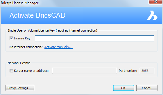

License Key
Allows to activate a single user or volume license key.
  1. Enter a license key in the License Key field.
  2. Press the OK Button.
    The license is activated over the internet.
    A license file is created.

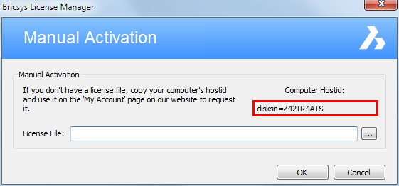

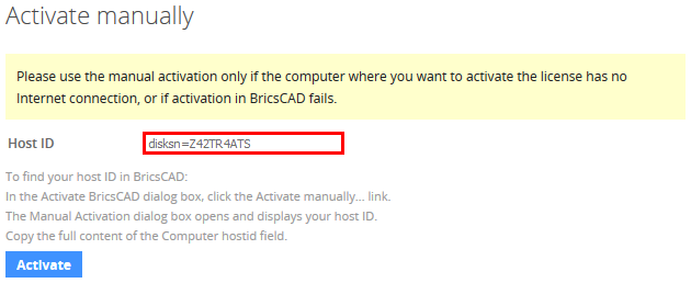

Activate manually...
Allows to activate a single user or volume license key on a computer that is not connected to the internet.
Another computer, with internet connection, is needed to retrieve a valid license file from the BricsCAD license server.

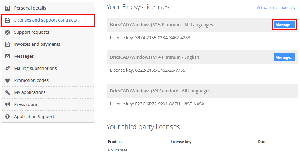

  1. Logon to your account on  the Bricsys website and select Licenses and Support Contracts.
  2. Click the Manage... button of the license you want to activate.
  3. Copy/paste the computer host ID of the computer you want to install BricsCAD on in the Host ID field.
  4. Click the Activate button.

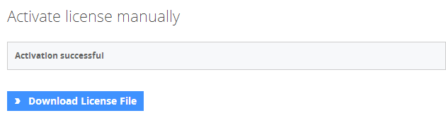

  5. A license file is generated and made available for download.

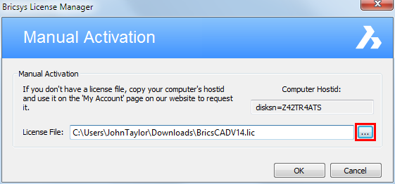

  6. Click the Download License File button to download the  BricsCADVxx.lic file.
  7. Copy the license file to the computer you want to install BricsCAD on.
  8. Click the Browse button () on the Bricsys License Manager - Manual Activation dialog box and select the license file.
  9. Click the OK button.

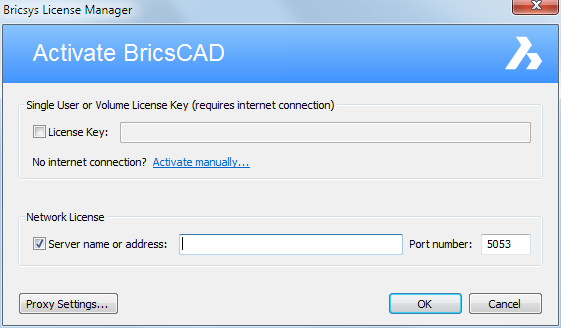

Network License
Allows to retrieve a network license from a license server.
  1. Type the host name or IP address of the license server in the Server name or address field.
  2. Type the port number in the Port Number field.
  3. Press enter or click the OK button.

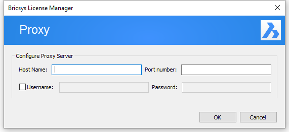

Proxy Settings...
Allows to specify proxy settings if your computer connects to the internet or a local network through a proxy server.
