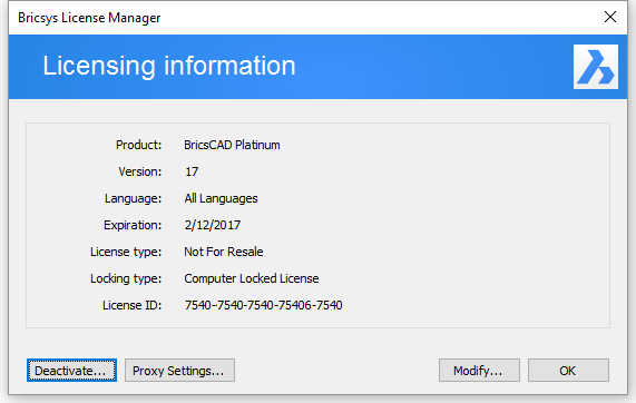

Reports the BricsCAD license information in a dialog box.
Allows to modify or deactivate a BricsCAD single user or volume license key.
command bar:  licproperties
: licproperties
Review license information, and then click OK.
Deactivate...
Deactivates the license key. BricsCAD can no longer be used on this computer. The license key is available for activation on another computer.
An internet connection is needed to deactivate a license key.
You must deactivate a license key:
  • To migrate a license key to a different computer.
  • When removing BricsCAD from a computer permanently.
  • Before installing a new hard disk, changing partitions or upgrading the operating system, e.g. from Windows 7 to 8.
Proxy Settings ...
Allows to specify proxy settings if your computer connects to the internet through a proxy server.
Modify
Displays the Activate BricsCAD dialog box.
See LicEnterKey command.
