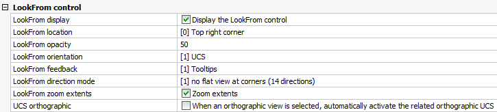

Settings
Displays the Look From control settings in the Settings dialog box.
